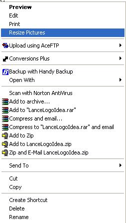

John -
If MS image re sizer tool is installed, and you right click on the image from within explor, at the top of the drop down menu you'll see this

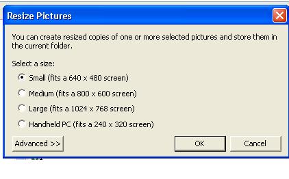

Click resize picture and you'll see this
say OK, and it will dump the resized image into the same folder. Another way to resize and its quick and easy is to use MS Paint. open your image and click
